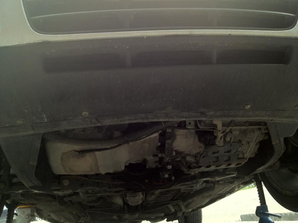

1. Jack your car up, and support it with jackstands
2. Remove all of the torx 20 screws that secure the weather guard to the front valance/bumper

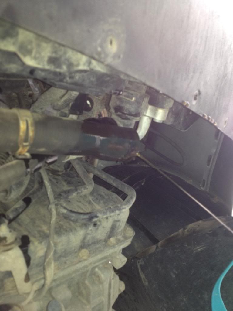

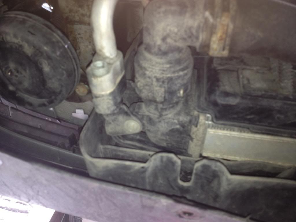

3. Now you can clearly see the lower radiator hose which you will be disconnecting to drain the coolant (NOT THE STEEL HARDLINE, the black hose) lol you can never be too sure
Step 3:
1. Find yourself a big old bucket/container/pan and put it under the lower rad hose
2. Take off the coolant reservoir lid to allow full drainige
2. Disconnect the lower rad hose and allow the coolant to flow out, should take around 5-7 minutes
3. Another method is to unclip the connector from the actual rad, instead of taking off the hose. Honestly, either way is fine, this is just the way i chose to do it.

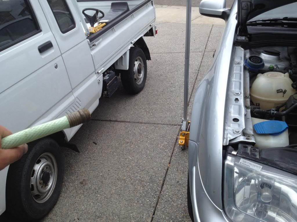

1. Grab your garden hose and dip the end into the coolant reservoir and fire it up (this was the kind of luck i was having that day):mad:
2. Turn your car on WITH THE BUCKET STILL UNDERNEATH
3. Regulate the flow of water so that its not overflowing and soaking your bay, and sit back and watch as all the old crappy coolant is flushed out.
4. Do this for about 10 - 15 minutes, or untill you see the water running clear.

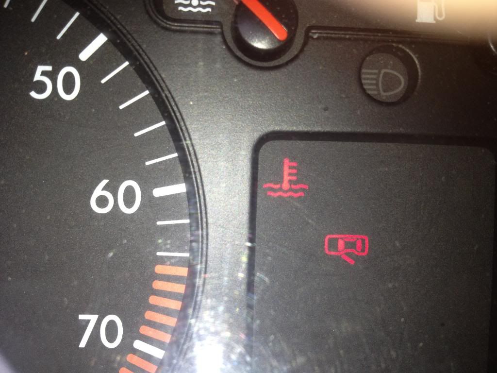

2. Get in the car and watch and wait for the coolant sensor to trip, showing you that you have very little coolant within the system. once you see this, turn the car off NO MORE THAN 10 SECONDS AFTER YOU SEE THIS WARNING
3. Running the engine dry of coolant (or in this case water) Can do some serious damage to your water pump, and beleive me, you dont want that.

1. Get back under the car and re-connect the lower rad hose, and make sure to put the clamp back as close as you can to where it was in the first place.
