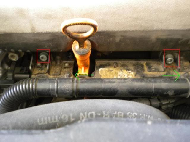

2. After you have removed the upper Y hose, you will find on the front of the intake there is a metal plate that has a plastic air hose mounted to it as well as the oil dipstick. First you will see where the plastic hose is attached to that plate by 2 10mm nuts. Remove the nuts and loosen the air hose from the plate. You may want to unplug the hose at its connector to the right of the intake to allow it more movement. Then you will see 2 5mm allen (hex) bolts connecting that plate to the intake. You will want to remove those to allow that plate to move a little so you can get your hand in the tight spot underneath the intake. You can remove the intake all together if you would like, it would make access much easier but is time consuming. The green arrows denote the 10mm nuts and the red boxes are the allen bolts.

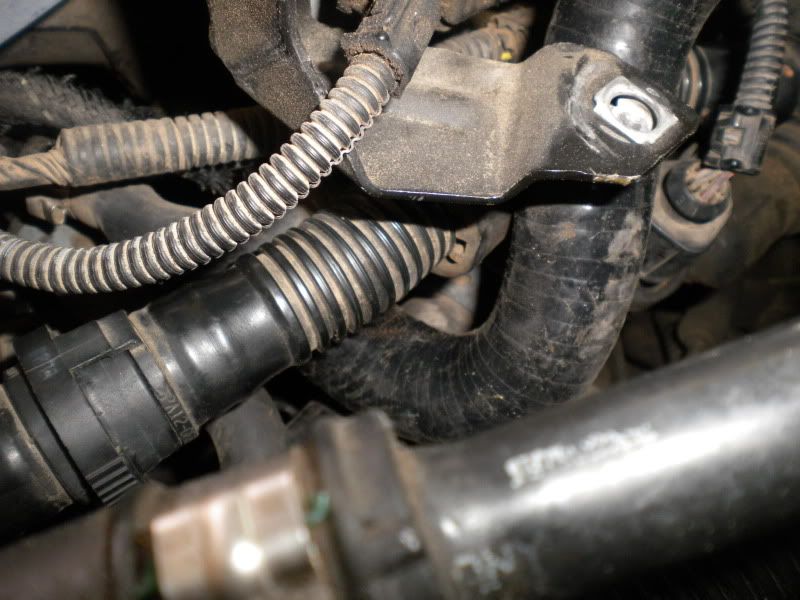

3. After you have loosened the plate, then comes the fun part (if you didn't remove the intake). You will see a 90 degree hard plastic hose connected into a 1" diameter hole in the block, this is where the flashlight comes in. This hose is held in by a retaining pin. You need to first remove a white electrical connector from its clip-in holder (Sorry but I couldn't get my camera in there good enough to get a picture of the white connector), if you dont take this connector out the retainer pin will not come out. After the white connector has been removed there is plenty of wire slack to move it. You will need to then take a long flat head screwdriver and stick it between the intake and begin to wedge the pin out of place, but not too far. You MUST keep this pin, do not drop it or misplace it or you will have to go get another one. After you have loosened the pin you can reach in from the right side with a pair of needle nose pliers and completely remove the pin. The pin is difficult to see in the pic but I outlined the head of it where the screwdriver needs to be placed and then the left side of the pin.
4. After the pin has been removed you may have to wiggle the hose out of its socket to remove it. I had to take and spray a VERY SMALL amount of PB Blaster down there to get it out. Once the 90 has been removed from the block you can then go to the right under side of the intake and find where that hose makes a T. This is where the PCV valve is located. There is a hose that is connected to the top of the T via a one time use clamp. You are going to have to break that clamp and remove the top hose from the T to be able to remove the vent system. Once again I couldn't get a great picture.
The top most aftermarket hose clamp in the photo is where you need to remove the stock one. After that hose has been removed you can now pull the old hoses out very carefully. When I did my ******* install I yanked that stuff out and ended up breaking the 90 hose. I attempted to epoxy it back together... did not work out so well.

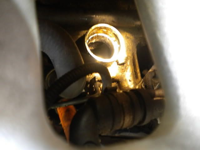

5. Once the old vent system has been pulled out, I took the time to clean where the 90 hose connected into the block. My original hose had deteriorated, and left some stuff behind.

Hole before cleaning. The green O ring is still in there:
I found that if you remove the orange dipstick tube totally, then you get more space to work with and you can push forward the bracket a bit to get a flashlight into the area. This is a good time to replace the dip stick holder as they get brittle anyhow. Here we see the bracket pushed out of the way:
I put a paper towel in the dip stick hole to prevent crud from getting into the crankcase. You can also see the edge of the hole where the crankcase vent hose was removed:
