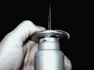

Coilover Parts Identification
All parts laid out
Here is the complete Coilover set fully assembled.
Front Coilover parts
Rear Coilover parts
Polyurethane isolator pad & spring perch
Polyurethane isolator pad on the spring perch
Polyurethane isolator pad & Top Hat
Polyurethane isolator pad on the Top Hat
Spring Perch and locking ring
Spring Perch & Locking ring in High Setting(bolts on bottom)
Spring Perch & Locking ring in Low Setting(bolts on top)
Front String @450lbs. & Rear Spring @350lbs.
3 sizes of O-Ring spacers, Allen screws, Polyurethane isolator pad
