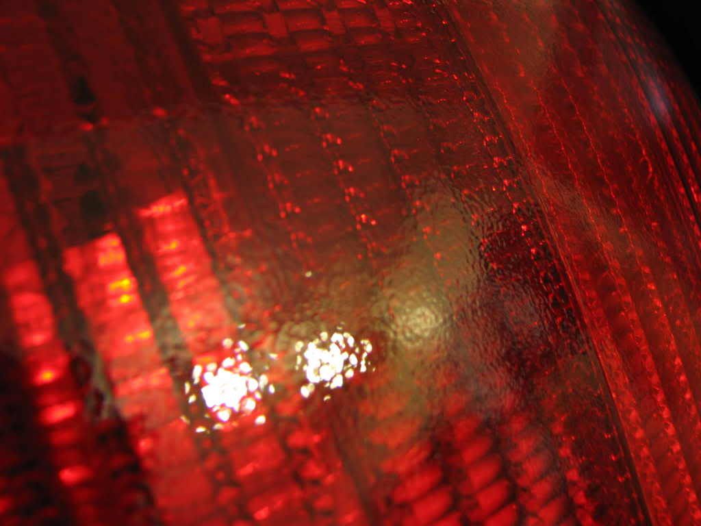

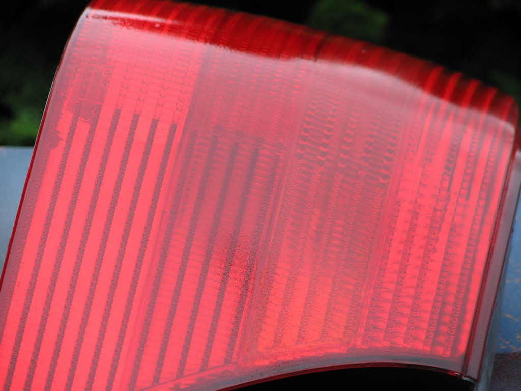

here are the simple steps

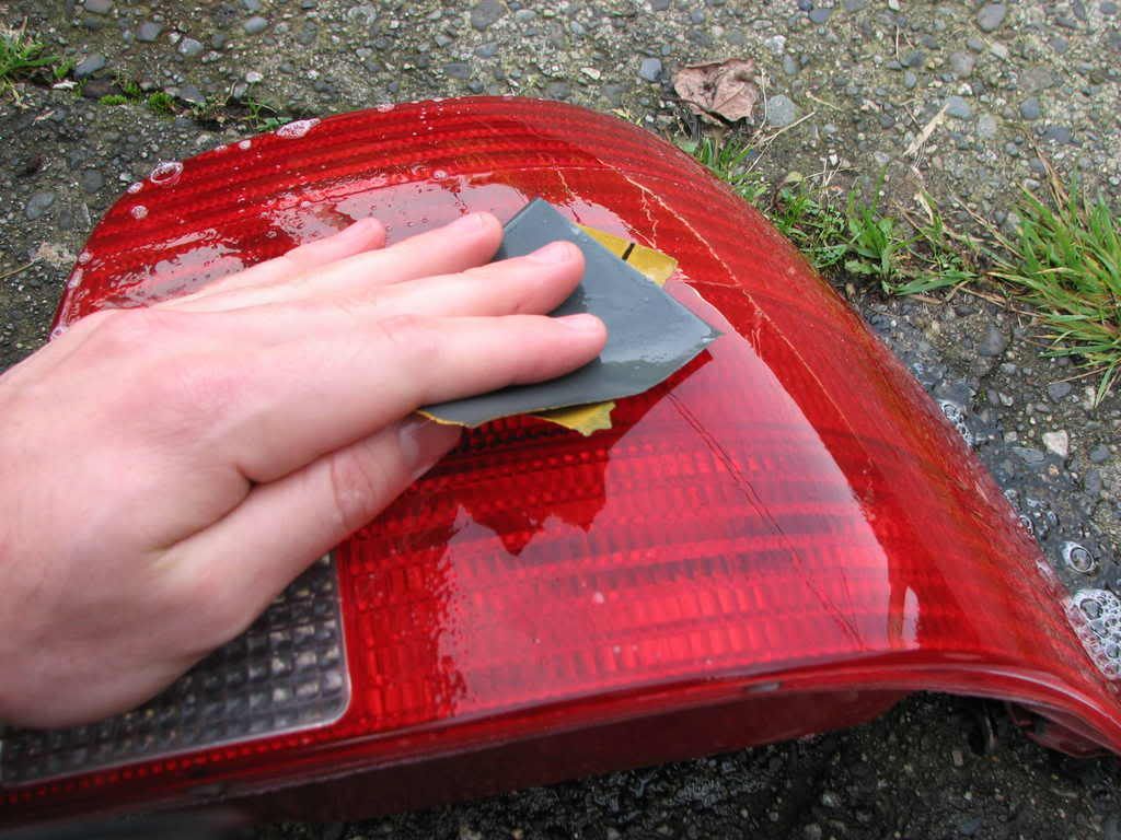

1- Wash it
2- Wet Sand the whole taillight with Grit 1000
3- Wash and dry
4- Mask area you do not want to tint with tapes and newspapers (I wanted to remove the amber signal only but some guys like the reverse light tint as well, up to you. FYI: tinting reverse light can be illegal in some places)
5- spray a VERY LIGHT coat of transparent candy red and wait 20min
6- Spray a 2nd light again and wait 20
7- Spray a 3rd if needed and wait 20 (picture below shows result after 2nd coat for me)

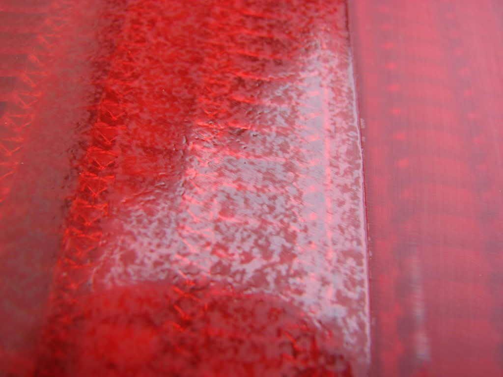

8- Now wet sand gently again with 1000 grit + wash and dry
9- after sanding, if the red is not uniform, spay the whole taillight with one light coat of candy red and resand, if red is uniform skip this step (I didn't need it )

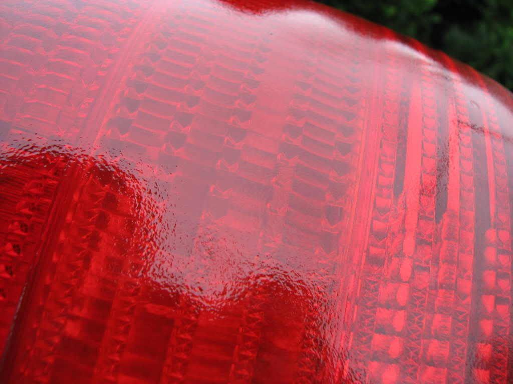

10- spray one light coat of Clear Coat Enamel and wait 20
11- 2nd clear coat and 20
12- 3rd clear coat and 20
13- Re-install the taillight after 2 hours min dry time
14- for best result, use a Polisher like UDM with a a light compound like Meguias #2 or #83 to perfect the clear coat reflection

well you can also use the night shade for a smoked look, they just used the red for the step by step...but I'm accually gonna do the red idea on the mk2

so im confused cuz th epictures arent there, did you spray the inside or outside of the light?

yeah thats wierd...you spray the outside...I'm waiting on a couple of cans from VHT...when they come I'll post up new pics

nice job on that man i would neverf have been able to tell theres a yellow lense under it

Those are the original pics..not my own, currently the two cans I ordered are on a 2 week back order...paid up front before I knew this...freekin crooks:mad:

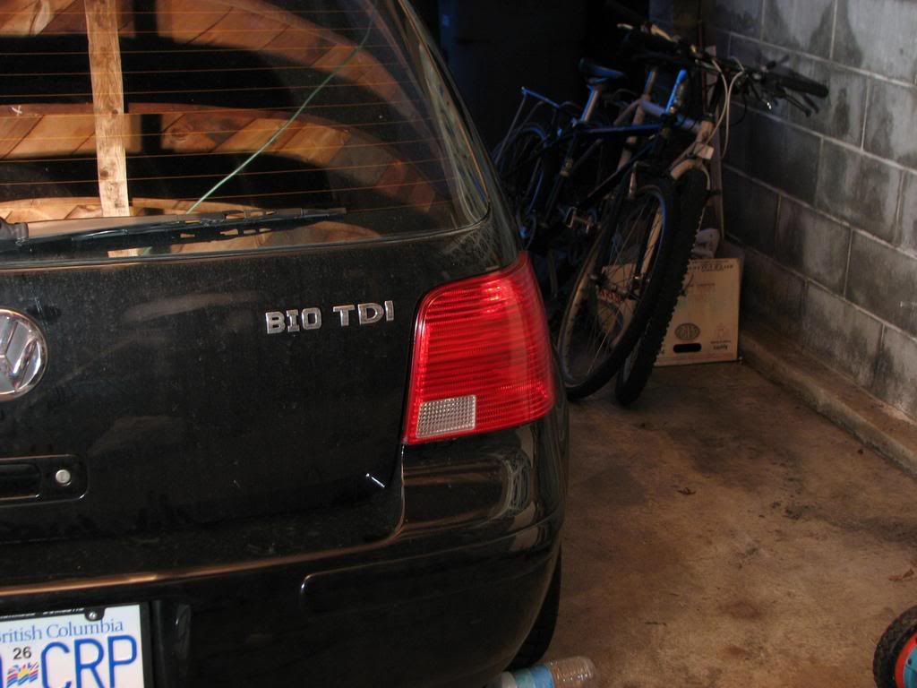

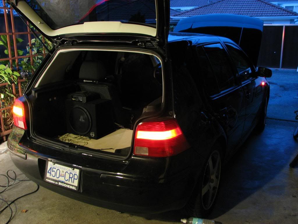

AllShoNoGo
2,465 Posts
Discussion Starter · #18 ·
posted some pics of my tails in my profile album...pics are in a garage with the flash off...hope to get some outside after I replace an axle boot
