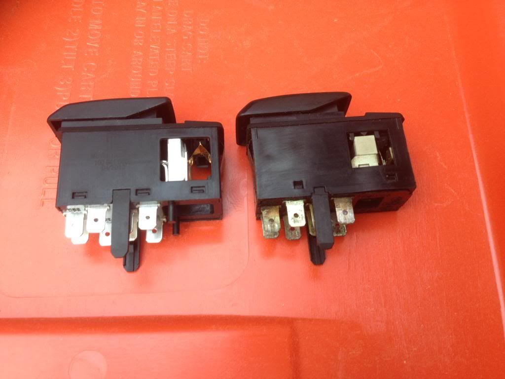

Hi guys, I have an 85 jetta. The horn blows for no reason or when turning the wheel or using the signals. Also the tail lights + tag lights quit about the time when the horn misteriously started working. I took the fuse block off and checked some things- nothing- cleaned the ground block- no result. I pulled the horn fuse and it still worked, disonnected the horn on the driver side ( are there 2?) and it still blows. Im pretty sure most of my issue is the headlight switch. headlights work only in one of the switch positions. i dunno which side is supposed to be up- the side with the dimmer wheel or the other? either way the position where they work its like daytime running lights. they turn on when you turn the ignition on. I ordered a new switch but i cannot connect it because of 2 nipples preventing connecting, otherwise it looks identical to the old switch apart from the icon and the nipples. the new one is a Meyle made in Germany. Help?!

Oh, the connector has 10 connectors, the switch only 8????
On a whim i cut off the nipples and connected. works just like the old switch just better action and no flickering. But still no tail/marker lights. then i kept messing with it and suddenly had marker lights / tail lights again. I figured out that i had the switch on backwards o_O Those nipples would have completely prevented connecting this way. Now i have Off, all lights on and the third position headlights brighter with all other lights on. Toggling the brightlight switch works and the horn seems to not go off unexpectedly. Is this how its supposed to be??

The headlight switch issues seemed to be resolved but i still dont think i have the right switch. I have 3 positions- off, marker lights and bright lights on, marker lights and bright and low lights on. :/

3 position switch came in 85. 89-92 2 position.
