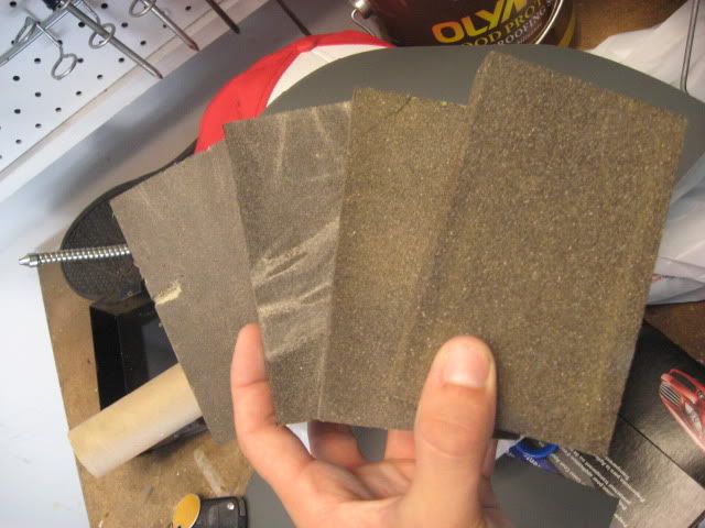

I also recommend sanding sponges, NOT BLOCKS. Keep the grit above 800 and they’re great for bends.

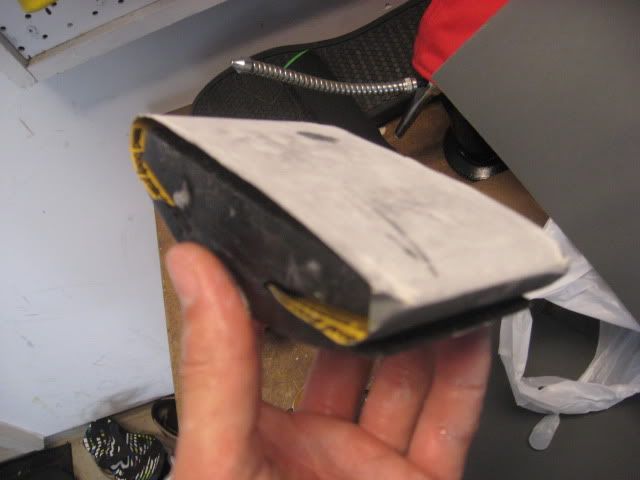

A sanding grip is nice too for long flat parts as it will keep you from getting irregularities from your palm or fingers. (bad picture, focus issues, sorry)

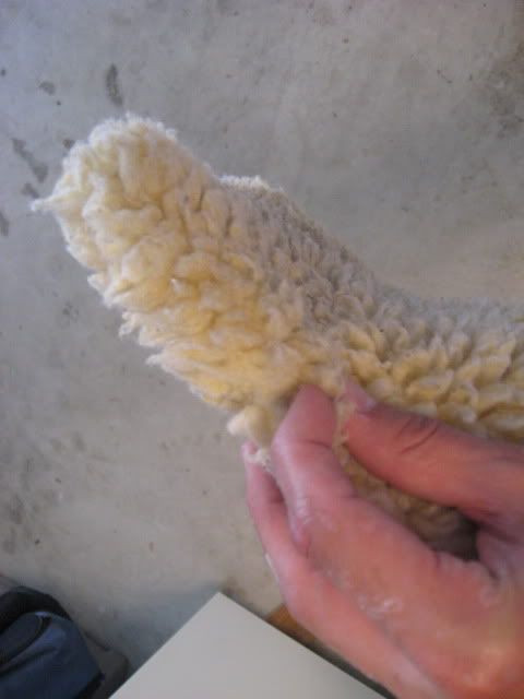

Your basic cleaning sponge is VERY bad to use. These things chunck and leave all kinds of stuff behind, as well as those feather cleaners.
Even your regular old towel or shop towel will leave behind residue. Oh and DON’T use sham-wows or any other knock off similar. It’s the ULTIMATE RESIDUE EVIL THING. Trust me. Paper towels are just as bad.

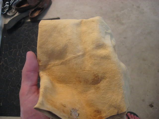

What you want to use is a non-cotton cloth or cow hide. Both can be found at your local autozone or pepboys, whatever. They look like this and notice there are no small remnants that will be left behind.
